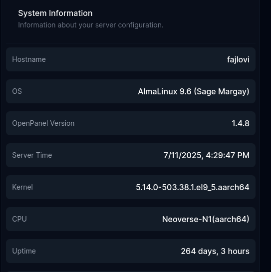

I forgot to ask how much memory the server has
/dev/fd/63: line 115: 62511 Killed "$@" > /dev/null 2>&1
as this indicates that the os is killing the process - most likely due to OOM (Out of Memory) or ulimit, so make sure you meet the requirements
dmesg | grep -i -E 'killed process|out of memory' - should show if that is the case
